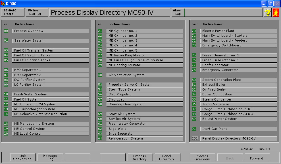

The following contains a list of keyboard commands to control and monitor the simulation.
F1 Run simulation
F2 Freeze simulation
F3 Stop, end simulation
F4 Snapshot
F5 Operating condition
F6 Scenario
F7 Recall picture
F8 Alarm log
F9 Malfunction page directory
F10 Variable page directory
F11 Alarm page directory
F12 Alarm silence
Home Picture directory
Page Down Next picture
Page Up Previous picture
Shift + F4 Replay/Snapshot dir.
Shift + F6 Initial condition
Shift + F7 Mark picture
Shift + F8 Alarm log acknowledge
Alt + F12 Toggle window decorations
Shift + Home Picture number (mdxx)
