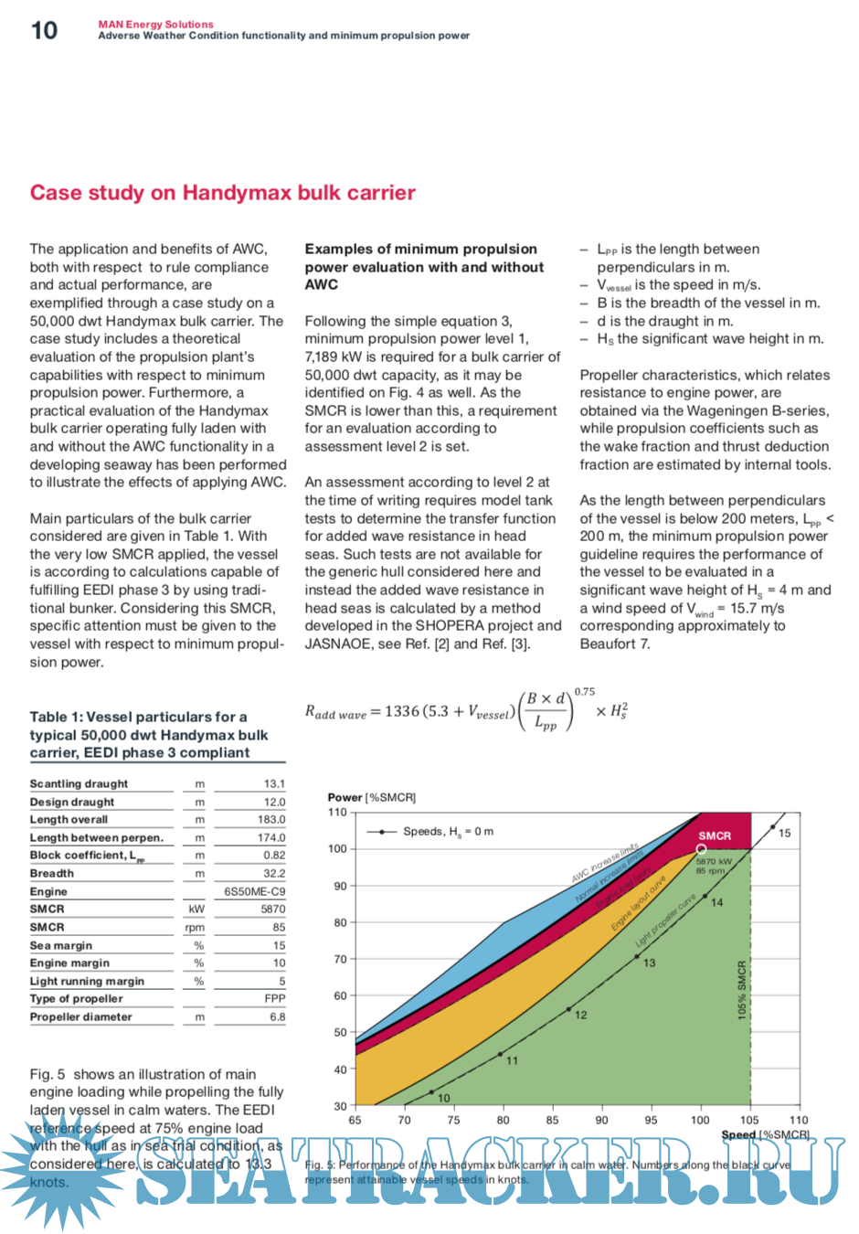

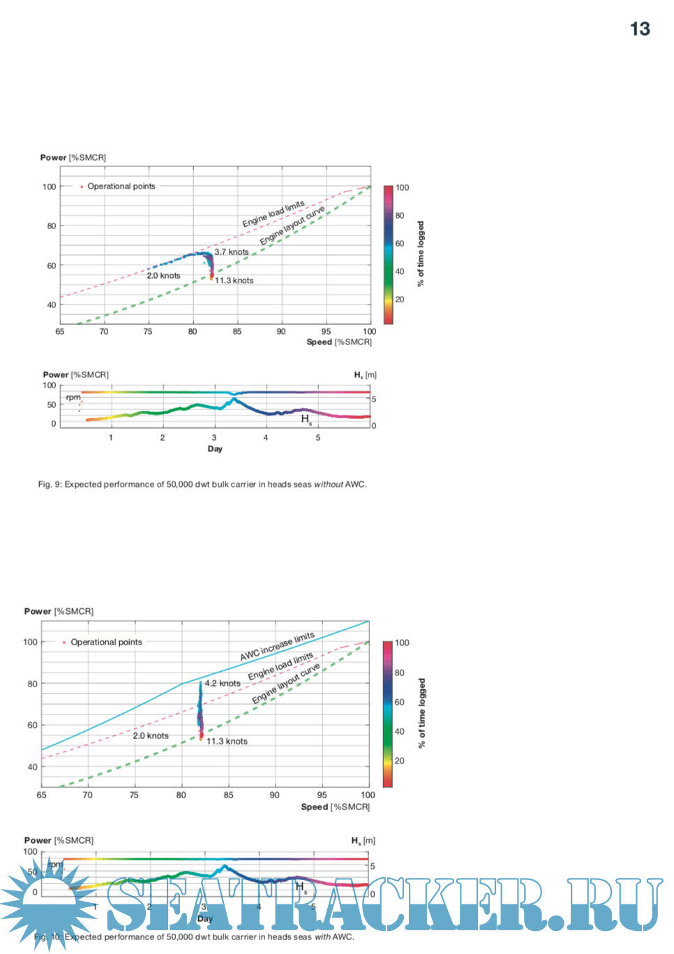

Description: This paper gives a detailed description of the challenge of propulsion in harsh weather, and introduces the Adverse Weather Conditions (AWC) functionality. The AWC functionality extends the load diagram of the engine as long as required in an emergency. This increases the heavy running capability of the engine significantly and increases the minimum forward speed of the vessel in harsh weather, without requiring an increase of the engine power installed.
