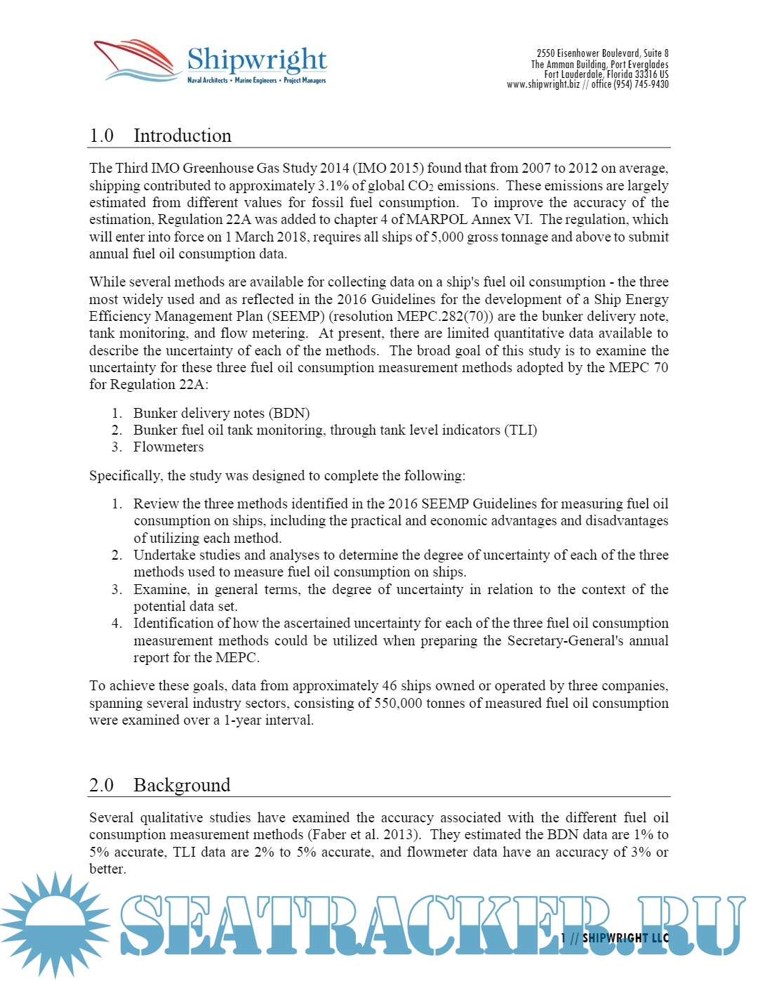

Description: The International Maritime Organization (IMO) has been actively estimating the CO 2 emissions from shipping for over the past decade. The results have been published in the First, Second, and Third Greenhouse Gas Studies (IMO 2015). Amendments to MARPOL Annex VI entering into force on 1 March 2018 will require ships to submit annual fuel oil consumption data to the IMO.

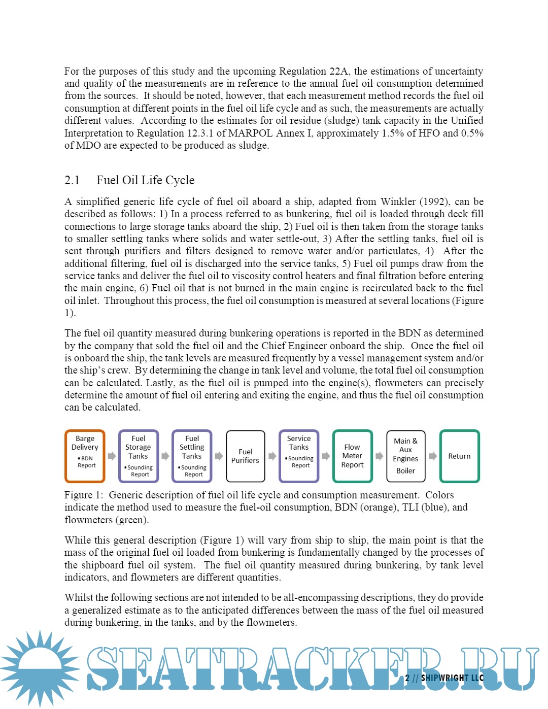

The three most widely used methods for collecting data on annual fuel oil consumption are the bunker delivery note (BDN), monitoring tank level indicators (TLI), and using flow metering. The IMO convened this study to examine the uncertainty for each of these methods.
The study estimated the uncertainty for each of these methods using 550,000 tonnes of measured fuel oil consumption from approximately 46 ships owned or operated by three companies.
